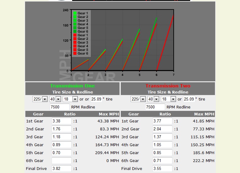

I did the ratio comparison of the F40 not too long ago, and it would IMO be a really awful choice of transmission for this car. Also I doubt the F40 is much stronger than the F35 from the specifications I've seen.
http://www.ecimulti.org/scratch/gear_comparison.jpg

Gimp, I don't see what about those ratios is bad-- Closer 1-4, farther 5-6. Better acceleration and MPG. Trans is plenty strong V8 guys use them in Fieros, and I am looking into the new parts available with the 2011 Regals that come with F40s and LNF-variant motors to see if I can acquire some of the parts for the swap. Gimp, you also got a PM about that E85.
We have the torque to pull the longer gears, I'm just thinking all the extra shifting in the end is going to be a wash. Kinda like all the turbo K series cars I've ridden in, they end up shifting all the time and get almost always seem to get pulled.

Not trying to be a jerk or anything man, I love to be proven wrong.... just don't think its a good transmission for the Cobalt.
