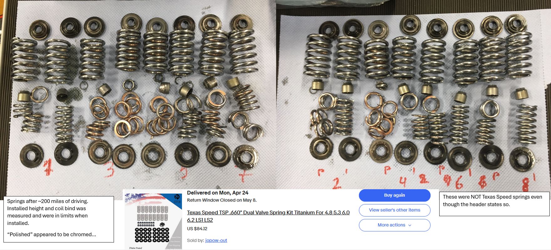

This seems to be solved now. Almost all valve springs were broken. I havent disassembled the heads yet but I hope valves and guides are OK.
This has TSP 224 cam with .600" lift. Valve springs I bought from Ebay falsely thinking I was buying TSP stuff but the ad didn't actually say them to be TSP parts, only the heading mentioned Texas Speed and the package was delivered from China. These springs were supposed to be for 0.660" lift and they came with retainers and seals. When installing those I wondered that they don't look polished, they look chromed. Now I know those were chromed and I should have thrown them to the bin before destroying the engine with them.
Any suggestions for new springs? Beehive seems to be out of options with .600" lift?
