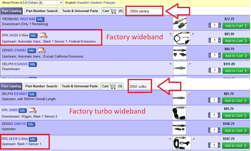

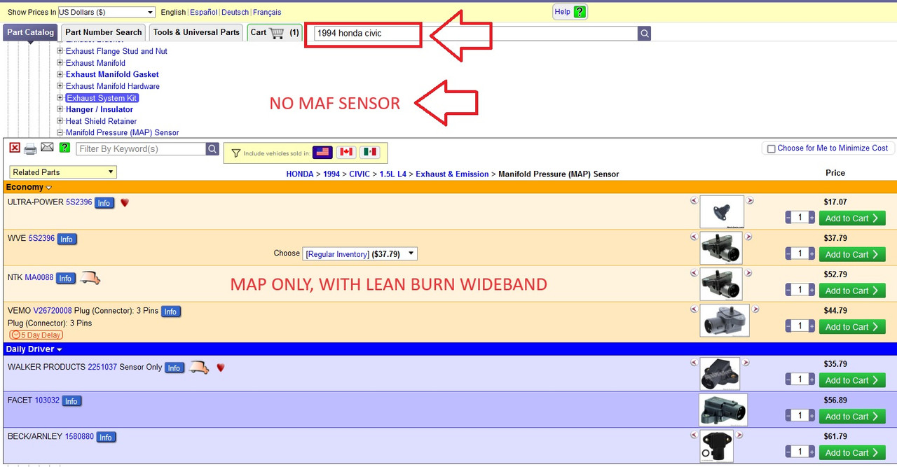

    Here are some examples from stand-alone tuning we use Closed Loop Wideband to target these ideal a/f ratio for particular combinations
    This one is a 2.5L powerglide running 35psi alternates between 93 and E85 so there are some Alcohol enrichments that take place on top of this display values, Haltech ECU
    This was a 13:1 compression 427cid LS style engine in a heavy vehicle with 4l80e, Holley ECU closed loop wideband
    None of these targeting is possible in closed loop with narrowband sensors. It will not allow you to refine the target like a true stand-alone ECU.
    It also prevents you from enriching gradually. With the OEM ecu in closed narrowband it will produce 14.7's all the time and then suddenly smack with power enrichment rich air fuel ratio. This is not ideal or desirable, you want a gradual change in air fuel enrichment over time smooth, not a sudden full rich condition. Just ridiculous to leave it like that when we have full control. But some people think its 'the right way' just because the factory does it that way.
    Finally here is my car example. Tuned around 2020 I put 40,000 miles since then open loop and as you can see still tuned just fine, never been closed loop never used a narrowband, I daily driver it and achieve superior fuel economy and drivability that the factory methodology.

    It's not a standalone system. It doesn't have functional widebands. You can't tune a GM computer open loop and make it work like a Holley. Simple as that. To promote open loop tuning on 90% of the street vehicles being discussed here is hack tuning.
    This is not an accurate VE table. Anyone who comes up with that should never be listened to about anything.
