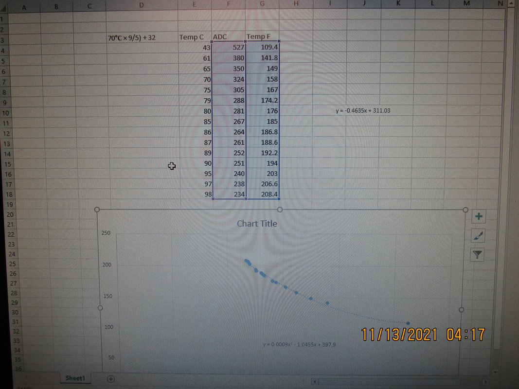

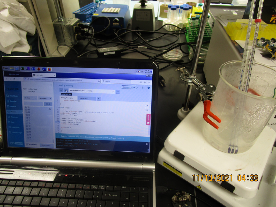

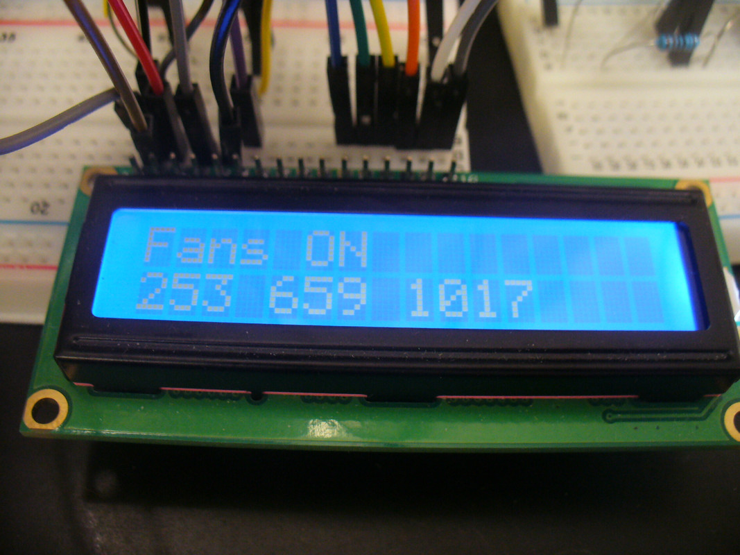

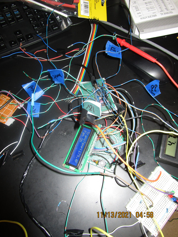

    I design voltage curves for sensors and deal with analog input frequently, here is one for my car specifically a transmission fan activation and LCD, because OEM ecu does not control transmission fan I make a darlington pair pull the automotive relay using a cheap 1/8" NPT temperature sensor, here is my curve fit and voltage divider for it
    Here is analog voltage inputs to the microcontroller, parsing 0 to 5v
    253, 659, 1017 , Different voltage dividers setup for different sensors on the ADC, 5v going in is read as something like 4.857v and converted to a 0 to 1024 range digital step input which refers to analog voltage. It is a digital representation of analog voltage.
    The ECU has many influences, injected/induced currents and internal components such as diodes which create voltage drops along the way and narrows sensing voltage range and some causes an offset. This is a typical problem with all analog voltage sensors and why they must have clean power and ground coming and received by the ECU to be at the same level using a voltage controller which takes a much higher voltage like 12v or 9v and turns it into 5v steady input.
    https://microchipdeveloper.com/xwiki...-offset-error/
    https://www.allaboutcircuits.com/tec...pecifications/
    If you understand what analog voltage offset is. Then admit it will be present in the EGR Input signal and actual ADC input voltage can not truly be reported by the scanner. Then you would see why all formulas require further addendum to the math formula supplied so far.
    Also if anybody needs a transmission fan and temperature controller my code and setup is available.
