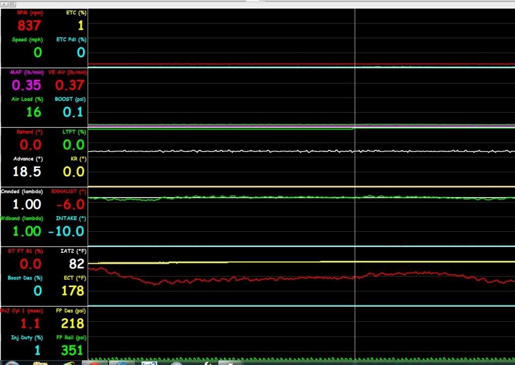

    What's the big deal? All you have to do is make a log like this...
    Ha, good thing you guys don't know where I live, I have a feeling I'd have some angry LNF owners in my driveway after this thread! Sorry! I think I did say something about this stuff being tricky didn't I? lol.
    Dayhoff I took a quick look at your log, it looks like you do have some tables fighting each other. Look at ALL your spark tables like cranking, IAT, ECT, the multipliers for those, etc. They all interact. Also look at smoothing between cells. If you're way off between one cell and another, obviously it's going to jump back and forth when the idle speeds or loads start surging. I keep saying this, but it's so true. Get a little too much of ign timing, or airflow, or even fuel mixtures and it's gonna go wacky.
    Here's another thing I do to try to keep track of changes, it might be obvious and something everyone is already doing, but maybe not. I number every one of my tunes, and put a description of what I've done in the title. Like this... 2---08 Saturn Sky tune #811 50 percent mix between huge cam changes and what was working before
    That way I can always back up to what was working last, or I always know what tunes to compare new changes to. I'm not sure how much you guys are using the compare tools, but you should be using it constantly. I'm always comparing to what I've just changed, or my last good running tune, or even my bone stock tune. That way I know exactly how far away I'm getting from stock or what was working ok before. There's so many times, like this tune file is named, that I make a change and realize I was in the right direction, but a little too far. I'll compare to my tune from before I made the last change, and cut those changes by whatever percentage I think it will need, like this one being 50% between what I tried and what I had before. Make sense? Or obvious as H#ll and why is he telling us this stuff we already know? lol.
    Sorry this is getting you guys a little frustrated, I didn't mean for that to happen. This stuff is so cool though, you can beat your head against the wall on something for the longest time, then all the sudden it all makes sense. Sometimes you give up, go back to it months later and wonder why you had such trouble with it. The reason I keep messing with this tuning stuff is it's a never ending learning experience. I've never had anything where I learn so much, and for such a long period of time. I can go weeks without doing anything to my car, and then I come up with a theory, try it in a few tunes and end up making a huge discovery that results in my car running even better! Yeah it's frustrating, but hella rewarding at times too!

    Here's a log before I made a few more tweaks to get the timing up a little more. Notice how when it's in open loop things are actually relatively smooth, but once she goes into closed loop ALL hell breaks loose! lol
    That one is looking really good! Same thing, try lowering desired idle, it doesn't have to be that high. If you drop the idle down 50 or even 100rpm, the throttle won't do that jumping up to try to maintain the higher idle speed. Once you get things that close, make sure you save that tune and make minor changes slowly to get it dialed in better. It's really not that bad, and you let it idle for a long time too. How often are you going to let it idle that long on a cold start? It might be better on an actual normal cold start and drive away after a few seconds.
    Another thought for you guys, how many miles do you have on your cars? Have any of you cleaned your intake valves? When they get gunked up it does make the idle rougher. So many other things might also be effecting idle smoothness, like spark plug gap, fuel quality, mixtures, etc. Gapping the plugs too tight will make the idle rough. So many guys close the plug gap up too far because of "spark blowout" (bs), and they end up with other problems they don't even realize. Just a thought.
