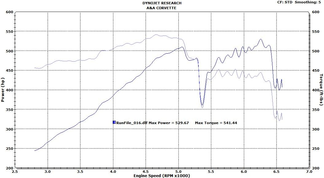

    I'll post a dyno sheet. You'll see that the wall I hit at 5200 is something totally different than the throttle closing.

    This is what I'm hitting. I don't even see anything in the logs, at this RPM, that would cause such an extreme drop. AFR, although maybe a tad rich, stays stable, spark timing doesn't drop drastically.
    What could be making it do this?
    The attached log file correlates to this dyno graph.
    I just don't see anything in the log file that changes drastically at 5200 RPM.
    This is sort of uncharted territory as I'm pretty sure I'm the first to build a supercharger system for these cars. I think it's got great potential once I get this figured out. I'm just hoping somebody much smarter than me (most of you guys on here ) has an idea that I'm missing.

    Quote Originally Posted by kangsta View Post
    You only have about 1deg timing at 5600rpm. Stop the KR and you will get the power back
    I actually should have posted a different run. All that KR is false. That's a whole other issue.
    It's only got 5# of boost at that point and I have a whole can of Torco in it. If that was real KR and I turned it off completely, I'm pretty sure I would have blown it up by now.
    I turned off KR altogether and it still hits the same wall.
    I'm off to SEMA for a couple of days so I can't play with it until Friday.
    I have some colder plugs coming for it. Nobody had a listing on the LT1 plugs. I have a 2014 Jeep SRT and the plugs, evidently, are the same. I just got another set of colder plugs for that to try. I'll feel safer with them in it.
    If I were just looking at the dyno graph, I'd think a bad plug or wire or something. I don't see the O2s spiking lean, as I would expect from a bad misfire, though.
    If it went pig rich at that point, the graph might take a big hit like that as well. But, again, the wideband doesn't show it.
    I'm going to lean it out, as 06blackg85 has suggested and see what happens when I get back. I sure hope somebody makes pistons for these pretty soon. I may need them.
    Thanks, all.
