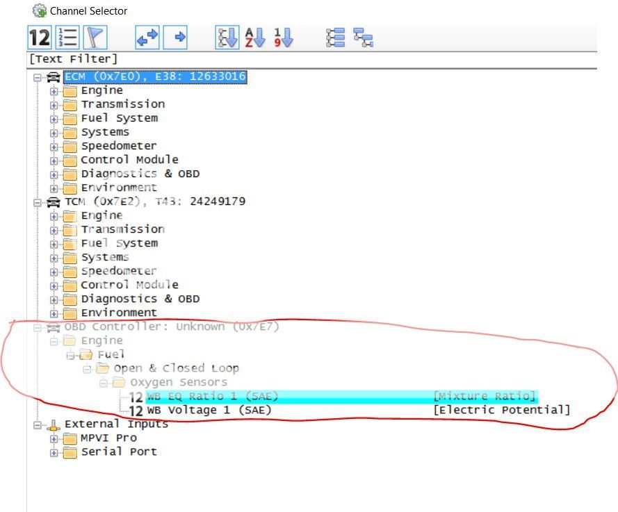

    this is where I selected the 30-0300 (Dr. Mike flashed)

    Mine worked perfect, first try. You have to log WB EQ ratio 1 (sae). Delete anything else you have that is in lambda. If you have an external input setup for lambda and this then it will flip back and forth really fast between the two
    Also change the logging rate to as fast as it'll go
    I'll post some pictures and a log later, but it 100% worked for me first try.

    Connect to vehicle, repoll for supported parameters. Add channel, search for "WB EQ" and see if anything shows up
    I just stuck the sensor in the tailpipe so it was showing a bit lean

    im not seeing what you are. I see your running 3.2, im running 3.0. heres what im seeing...
