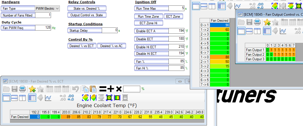

    Definitely a headscratcher. So setting ALL of the outputs (Fan output desired vs Current State) to 0 (zero) should make the PWM wire (Fan 1 wire in discrete) not output anything at all. It doesn't do this. The fan will still operate (come on) at what I am testing it with (199 degrees).
    Maybe in discrete, a zero will make the fan off? I don't really care about discrete though.

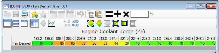

    PWM EV won't make the fan work despite what I've tried.
    Fan desired starts at about 84.5 at about 200 ECT (where I'm testing at). As the ECT climbs, this number goes down as it should.
    FAN Goes back and forth from 99.6 to 0 every second approximately.
    FAN 1 Flashes On Off in relation to FAN. When it is ON, it shows 99.6 and 0 at OFF.
    I think PWM EV is what would be needed for an aftermarket Spal brushless fan to work correctly. Something is making it fail though (in the E67?). Maybe there is another input necessary in the ECM that isn't present causing it to fail.
    PWM Electric does make the fan come on, but it acts like discrete. It comes on ramping up very quickly before coming back down to 85% (15% oem).
    FAN 1 shows ON.
    FAN Desired Speed Never shows anything here like it does in PWM EV.
    FAN Desired Ramps up to just under 85 when FAN 1 switches from OFF to ON. It is this ramp up that I believe makes the fans start very fast before coming down to a lower RPM. This number goes down to 0, but the fans aren't OFF until FAN drops to 0. I suspect this has to do with the values in the FAN DESIRED % VS ECT table.
    FAN Where is this value coming from?
    As FAN DESIRED goes to 0, FAN still has value and doesn't get to 0 for another 20 or so degrees. The fans are climbing in speed as this number heads to 0. Once at 0, FAN 1 shows OFF and the fans finally shut off near 181 degrees.

    I’m trying to digest everything you have posted there. The last paragraph made me think that box 18040 has something to do with the fan still staying on, even when the temp has been attained.
    The 18040 graph looks like a down shift and up shift strategy for an auto transmission. That way when you are holding at a temperature that is in the desired % vs ect, the fan isn’t being triggered on and off, on and off, on and off etc.
    So even if the fan is supposed to be at 20% at 200 degrees, it will stay at 20% until it gets down to 194 degrees then change to 10% etc or how ever you have it programmed in the 18040 graph.

    This is one of many, many reverse trials:
    PWM Electric just won't work correctly with anything I've tried.
    I feel that it would with PWM EV, but I suspect the ECM goes into fault mode due to either feedback or something expected not being present.

    But to give some input here, Brent posted the logic of the Spal fans (GM vs aftermarket) which are opposite to each other. GM uses 0-90 which is AFtermarket 90-0.
    With an Oem ecu and the aftermarket version of the fans, the PWM signal sent by the ECU to the fan is done by slowly ramping it up and down. So if you command 90%, its not immediately 90%. on my E67, it takes 10 seconds for the signal sent by the ECU to go from 0% to 90%. This results in a cat & mouse effect during startup (and if you have the fan deactivate at speed option).
    For cpd004, when your coolant temp hit 199.4, the ecu starts sending a signal. As it ramps it up, the ECU sends it as 5%,10%,15% ----> 80%, 85% , which the fan interprets inversely as 95%,90%,85% ----> 20%, 15%, and this is why your fan ramps up then slows down (it probably ramps up to 50% speed by the time the ecu is now outputing 50%).
    Nothing can be done to solve this on a GM ecu. If you're using a holley ecu I believe, you can actually change the output signal from PWM + to PWM -, which is basically a signal and its inverse.

    Thank you! This is likely why it doesn't completely shut off when commanded to do so. It is the same ramping effect in reverse for shut down.
