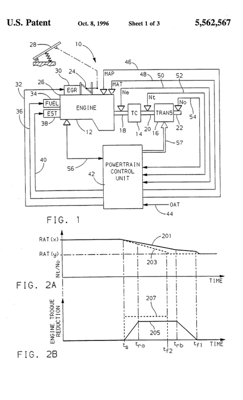

    From the patents that user exxo... forgot his name. He posted some helpful publish documents here is what I briefly (emphasis on brief) interpreted,
    From the document,
    "FIGS. 2A is generally illustrative of a ratio change (upshift) from one ratio RAT(x) to a lower ratio RAT(y). The ratio (vertical axis) measured as the turbine speed to output shaft speed ratio, Nt/No, provides a measure of the shift progression over time (horizontal axis).
    Shift start time and finish time are defined by respective event based thresholds such as predetermined ratio thresholds or timer thresholds. In the present example for instance it is assumed that start time ts corresponds to the ratio Nt/No having reached a first predetermined value related to the first ratio RAT(x), for example a value equivalent to 90% of RAT(x). Alternatively, start time ts may correspond to the expiration of a predetermined amount of time from shift initiation. Both traces 201 and 203 represent an upshift which at the time of initiation are characterized by equivalent shift torques. However, both traces 201 and 203 correspond to a proportional mix of input torque (ETQ*TQRAT) and inertia torque (ITQ) making up shift torque (STQ) that differs from a mix associated with baseline calibration conditions, for example barometric pressure equal to one atmosphere. Assuming that the proportional mix is weighted more heavily toward input torque, an uncorrected percentage reduction of ETQ based upon the shift torque STQ as conventionally practiced is invoked at start time ts as illustrated in FIG. 2B (dashed line 207). The shift progresses until the ratio Nt/No reaches a second predetermined value related to the second ratio RAT(y), for example a value equivalent to 110% of RAT(y), whereafter further reduction of ETQ cease and the final ratio RAT(y) is achieved. This point corresponds to the shift finish time labeled tf2. It is noted here that the shift time corresponding to the shift represented by trace 203 (tf through tf2) is undesirably of lesser duration than the desired shift time (ts through tfl). The conventional engine torque reduction control applies the same reduction (207) regardless of the proportional mix of input torque and inertia torque. "
    So it looks like you are right about it looking at Ne, Nt, No: The turbine, input shaft, output shaft speeds and relating them by some ratio and expected difference to determine when a shift occurs.
    Its intuitive and seems like the document describes the similar behavior we interpreted,
    therefore. The only thing I can think based on what we have access to is manipulate the gear ratio and tire size wizard to influence the ECU into thinking a shift has occured with a very small drop in RPM ... until we get access to those other tables. "Scaling" the tune except for MPH and RPM instead of injectors. Alot of work very little gain... I won't be trying that. And even then, I've seen 4000stall converters shift from gear to gear without any RPM drop at all. So uh... wth do with that... idk
    What we really need a pressure sensor inside a drum that can tell the ECU when the drum is fully pressurized indicating the shift is complete. Suuuureee

  10. #30
    Quote Originally Posted by kingtal0n View Post
    For a long time I Questioned how the OEM Ecu knows when the shift is completed. There is no way for it to tell from the transmission communication effort. Therefore it must be an algorithm based on some difference the transmission makes after a shift is completed. Exactly as you are suggesting, I think its correct. Shift timing I am pretty sure is only for adaption methods, it checks shift time and then adds pressure if the shift is slow and visca versa. I've turned my adapts off and tried all different numbers in shift time tables with no effect or change which more or less confirms it is powerless to influence. And when we break down how the transmission works internally- the only thing that really happens is pressure and volume fills a drum to bring a gear on. Solenoids to shift gears are either "ON" or "OFF" there is no PWM control over solenoids for shifting. Therefore following all of this reasoning the only shift timing control the ECU really has is shift pressure via EPC which we can clearly identify using Force motor current.
    For trivia purposes, just finished specing out and building my first 4L60E. Around 2005 the 4L60E incorporated a input shaft speed sensor. Not sure if all trucks / transmissions came with the sensor or not. Kind of hit or miss. I would think the computer could compare input speed to output speed to see if the gear / clutch pack has fully engaged. There's also a pressure switch manifold on the bottom of the valve body. I assume it simply shows when the pressure has stabilized for a given gear (wouldn't know slip). I'm just getting into tuning side now... Having similar issues with Torque Management pulling timing.
  11. #31

    Quote Originally Posted by weinerschizel View Post
    Thats a good point about the input shaft speed. I kept thinking of turbine and converter being the culprit and never even realized that the input shaft speed would need to drop regardless of the converter slip. Which throws a wrench into everything- why can't the input shaft speed be compared to output shaft speed to determine when the shift is completed?
    For example in a manual trans car, you shift gears and the output shaft stays the same speed but the input shaft is much lower now, and being attached to the engine via clutch the engine speed is the same as input shaft.
    In an automatic the gear changes and the engine speed can stay up due to slippage- but the input shaft still needs to slow down because there is a continuous solid link between input and output shaft speeds. Either input needs to slow down or output needs to speed up (tires spin).
    So that leaves me wondering why the hell the converter slip is confusing the ECU at all? Are we thinking about this all wrong? I have to think about this some more. It could ultimately boil down to a programming issue, segment swap related, ECU gear ratio recognition, something like that
    >.. Hmm just thinking outloud. There is a setting I Never fooled with in the Transmission page which asks something about converter slip. I wonder if the converter slip setting is somehow overriding the input shaft comparison.
