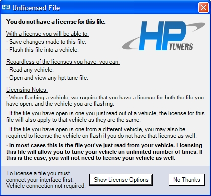

    It does not use any credit simply doing a read on ANY supported VCM. You can then open, view & even compare that file to other files. The great thing about this is now you don't have to license a specific file if you care not to but will help both you the end user & us develop product quicker since you'll be able to read files without needing credits from us to do so. You can license a file at ANY time by simply opening it and clicking the license options tab as shown here or just open & view the file by clicking "No Thanks".
    Its always recommended to simply read the pcm as it sits and license that file that you read from the pcm.

    No, once you've licensed the file to your MPVI hardware its there locked into the hardware awaiting your command. You should NEVER have to license that serial number AGAIN! If VCM Suite ever asks you to license the file again for some reason & your not sure why, STOP, do not license it & contact support at hptuners dot com with an infolog & the file its asking you to license and us figure it out before you use any more credits. Its much easier for us to fix things before they are broken
    Thankfully when if it ever does ask you to license something this warning will come up
    "Please select your choice carefully as this action cannot be undone"
    "The credits used will no longer be available for future use"
    "If you have any questions please read the help files & contact customer support"
    I cannot stress it enough how important it is for you to contact support BEFORE you make a decision your not sure of.
