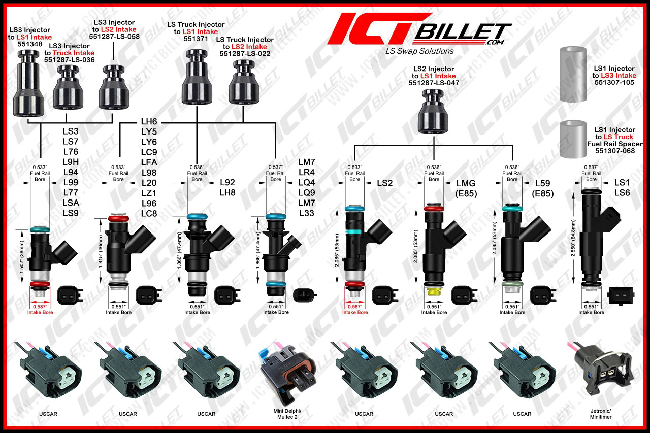

    You can use L94 flex fuel injectors. They are direct fit.

    Quote Originally Posted by verlon View Post
    They also do not cost $55/set. There is some supply chain weirdness with the 12613412s, and only that number. There is a huge surplus of them for some reason.
