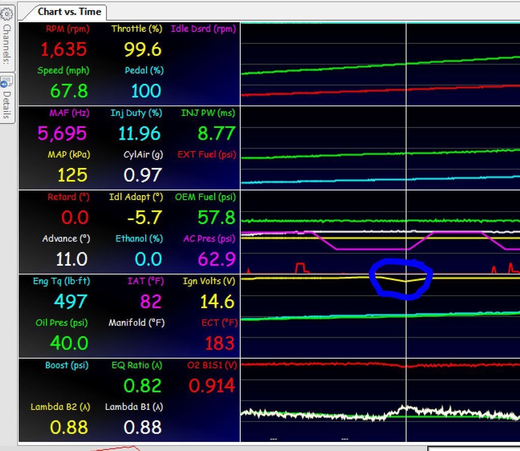

    So anyway, Now I made 1 correction after a few lower RPM WOT pulls using the AEM 30-0300 and first thought WOW, one correction and my error is so small now... which is seems to still be, however I'm getting some inconsistency in the Error at the first WOT pull, at least that's what it seems.. check it out. I compared injector pulse vs. RPM at the point where the AFR leans out between WOT run 1 (leans out at 1600rpm) and WOT run 2 (looks great), and they appear to be identical.. ---UPDATED - added fuel pressure to one of the pics... it is rock solid----... but what could this be? BTW, yes, I know, the Narrow Bands dip on the leanout and not something just the AEM 30-0300 is doing, so yes it appears to be real... (I figured gmtech16450yz would like that example)
    Camaro.Layout.xml
    125e 1st WOT LEAN.hpl
    125e 2nd WOT OK.hpl
    Attachment 59154

    Holy cr@p I love looking at logs!!!!!! lol. Yeah I know I'm weird.
    10_SS this is SO COOL! So wait, first of all, are you trying to say that the narrowband reading changing along with the wideband reading verified that the wideband data was correct? WTF ARE YOU TRYING TO IMPLY??? That narrowbands can be used as a "sanity check" to widebands? Now you're just crazy talking!!!!!
    Sorry, I couldn't resist. haha.
    Ok so I don't know exactly why you're getting that lean spot, but I can tell you where to look. This is a PERFECT example of logging AND charting the right stuff. I opened your log in my layout and immediately saw what very well could be the cause. Then I opened the same log in your layout, and guess what? I didn't see the problem! Good thing you were logging the data though, all you'll have to do is add it to your chart. Look at this screenshot...
    What I saw was that voltage drop right at the lean event. You didn't have ign voltage in your chart so you couldn't see it. What didn't look right was the fact that it was in the middle of the event. Then I looked at the polling speed for that ign voltage, it looks like it's updating at 1 second intervals. So that .2v drop doesn't look like much does it? But that's in the MIDDLE of the drop, it's an average of what that voltage did over a full 1 second period. Increase your polling speed for ignition voltage as fast as it will go. I'd like to know what that voltage was doing during that whole event. The voltage updated right before the start of the lean event, so it literally missed a full second of the voltage drop!
    The next thing I would want to see IF the voltage drop is what's causing the lean event is coolant fan operation. It looks like the fan might have passed through the 48-52% area of desired fan speed. Where are your fan settings? And does the ZL1 have relay controlled fans like the V's? If so, did the fan just go from low speed to high and caused a voltage drop large enough to effect the injector drives? I'm guessing here because there's a bunch of info still missing, but that's where I'd start looking.

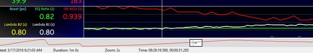

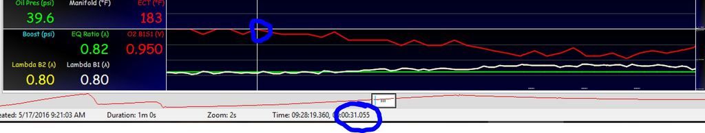

    I'm not going to beat this dead horse anymore after this, but I couldn't resist showing this screenshot from 10_SS's log. THIS was my whole point about comparing narrowbands to widebands.
    This is real world. This is valuable data. This is data that any "tuner" would be ignorant to ignore or deem "unusable".
    What I've done here is to "zoom in" on the narrowband data. I don't really care what the actual values are, although the low 9's reading does also give me an idea that it's too lean. I've set my chart to show a range of .85v to .95v, just enough range to cover this small event in the chart window. Obviously you wouldn't want to run this range normally, but the power to change ranges is there, why wouldn't you use it? It's extremely powerful. This example shows that perfectly.
    So look at the narrowband (red trace) vs. the wideband (white trace). Pretty cool huh? The narrowband IS telling you something, sometimes actually MORE than the wideband. Don't poo poo this source of information, it can help you tune cars. And don't try to kill the messenger of what may sound like a crazy idea. It may actually have some merit.
    'Nuff said, I won't harp on that point anymore. Just keep an open mind guys. It's what separates the smart people who come up with new ideas from the ignorant ones that just repeat what everyone else is saying.
    Here's the difference in reaction speed between that wideband and the stock narrowband. I'm measuring from when they both just started to indicate a difference in direction on the mixtures. The narrowband saw it first, the wideband saw it .23 seconds later. Dr. Mike, you can tell me if I'm doing that correctly. I know it's a barbaric way to see the reaction differences, but we're talking real world here, not lab equipment in a controlled environment. To me, I see the wideband reacting ~230ms behind the narrowband. Make sense? Like I said, it's kind of crude because you kind of have to interpret what constitutes a significant start of change trend, but it surely shows that the narrowband "saw" this event happen BEFORE the wideband. How much obviously can be debated, but between 100ms and 300ms would be my ballpark guess.

    Quote Originally Posted by GHuggins View Post
    I'm curious Mike, what are the delay times for the lambda pro unit? Only reason I ask is because I do power shift and transient fuel tuning with it on the dyno all the time. Of course I'm also using load profiles built into the dyno that simulates vehicle weight and wind drag coefficients. You would be very surprised how much that can change your air fuel tuning......
    I will say that I see what seems like full resolution data between shifts, at WOT tip in, and after WOT close throttle events clear with the AEM 30-0300, the NGK was just kinda smooth lined and very misleading in a way, but since you know not to use it for that anyway, no problem. Just nice to see more real AFR data go along with what you "feel", things start to make allot more sense.
    gmtech16450yz :
    Yea I honestly do not remember people saying ignore your Narrowbands completely, just said don't base your PE fueling off of them. Maybe they did I don't really care, allot of stuff like this goes without saying. And thanks for finding something tied to the AFR leanout, hopefully that's "all" it is, based on the slow steady recovery after it went lean it would make sense it was tied to voltage as V ramps up so does the fueling come back in line. I'll play with it more... thanks again for looking at it

    Quote Originally Posted by 10_SS View Post
    gmtech16450yz :
    Might be because your using a BAP? Heavily dependent on input voltage....
    Good point. That voltage drop just lines up too well with his lean event to be a coincidence. I'd really be looking at what caused that drop, how large it really was and what effect it had.
    It would be awesome if the MPVI had the capability to input 0-20v signals to log. It is possible to log a 12v signal like fuel pump feed voltage, I've done it before. You just need to build a simple voltage drop circuit coming from the fuel pump feed and then convert the dropped voltages back to their 12v equivalents in the hpt scanner. What I ended up with was being able to read my ~10volt to ~18volt fuel pump feed into the MPVI as a 0-5volt input, then converted back to equivalent 10-18 volt ranges in the scanner. (Talk about voltage offset errors! lol. I wasn't so concerned on the values as I was the signal and voltage changes.) It worked, and actually showed me that my idea of using a BAP in front of an Aeromotive fuel pump controller didn't work very well. At lower BAP gain settings it did increase the final voltage going to the pumps, but at high gain settings it actually made the output voltage worse. I always wondered if the same thing happened when guys put a BAP in front of a stock FPCM, but I never did any further testing to find out. Knowing EXACTLY what the voltage is going to your fuel pump(s) though is very valuable information. How many guys don't even log their fuel pressure though? Crazy.

    My BAP system is awesome... I get down to 30psi Delta pressure at 6500rpm. But, This voltage drop and leanout event did not happen at all today after 10-20 WOT passes while dialing in my higher RPM VE table.. I did check the FAN ON settings and they seemed to line right up to turn on high speed at 60%, which also happened right at the voltage drop... Here's a little snippet of my fuel pressure drop and injector pulse skyrocketing to compensate for your enjoyment. (this is untuned, so it is rich after 6000rpm)
    I tell you what.. this fast AEM is really helping me get my AFR right, very fast! It only takes 1 or 2 corrections, max. Before it used to take me 5-10. Im using 2nd gear pulls too.. . thanks Dr. Mike!! BTW is it normal for VE Airflow to max out at 512g/sec while Dynamic Air keeps climbing?
    125i WOTS on Harmon Rd 64F snippet.hpl
    125i VE STFT with WOT VE changes from 125h.hpt
