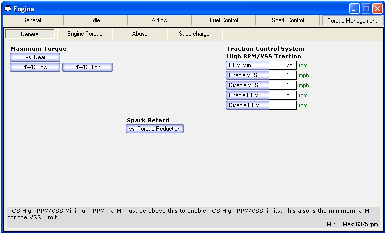

    Note: in the pics below the stock values are shown for a calibration (12216489) that requires the tables in Step 3 & 4 to be changed.

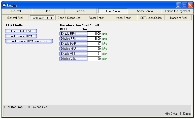

    Step 1: Change the RPM limits to whatever you want

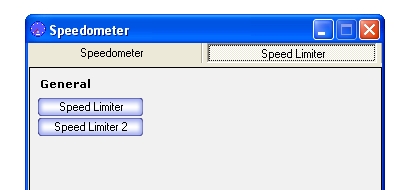

    Step 2: Change the Speed limits to whatever you want

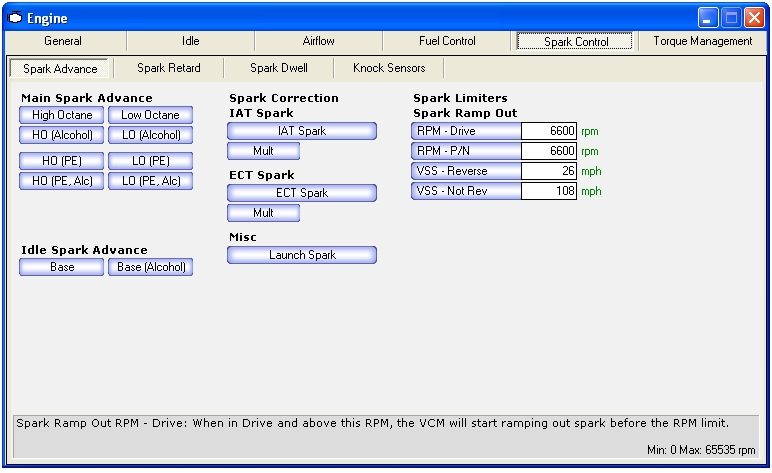

    Step 3: Raise the spark ramp out values so spark does not decrease at high RPM/Speed (not required for all calibrations)
    Step 4: Raise the TCS High RPM/VSSvalues so that 1,2,3,4 cylinders do not fuel cut at high RPM/Speed (not required for all calibrations)
